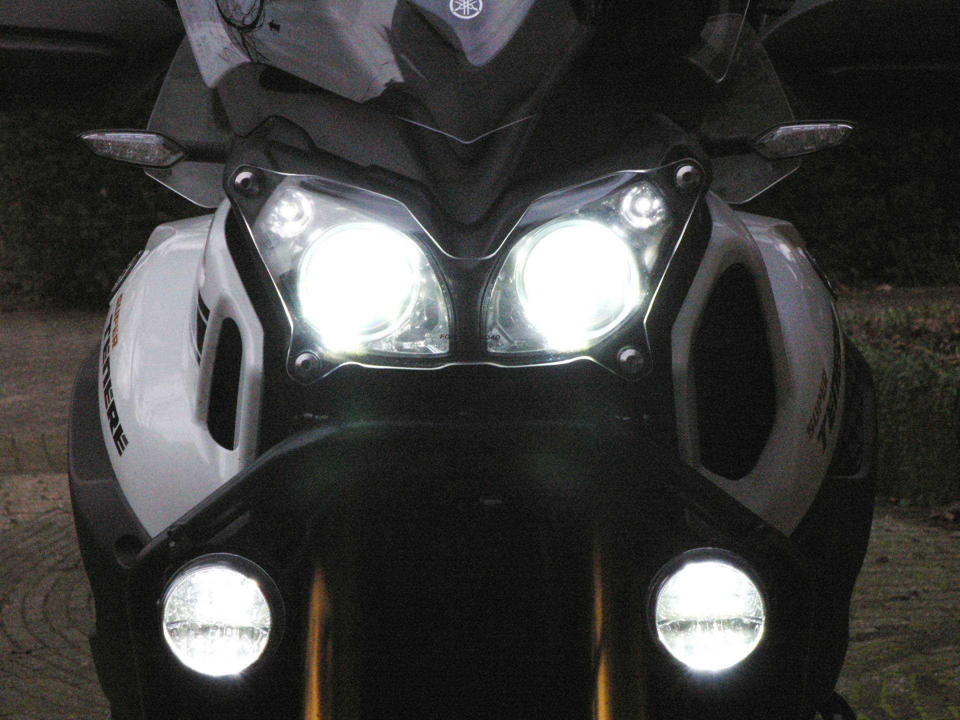

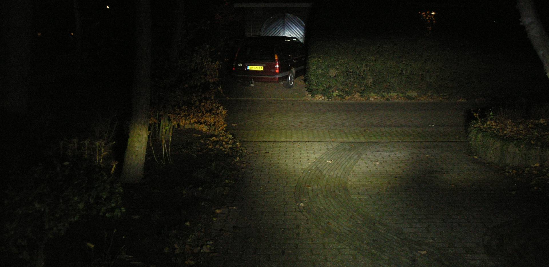

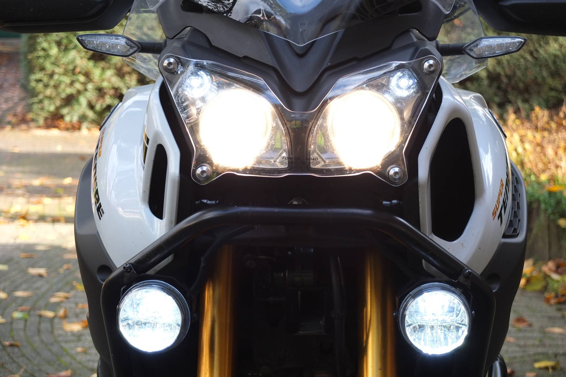

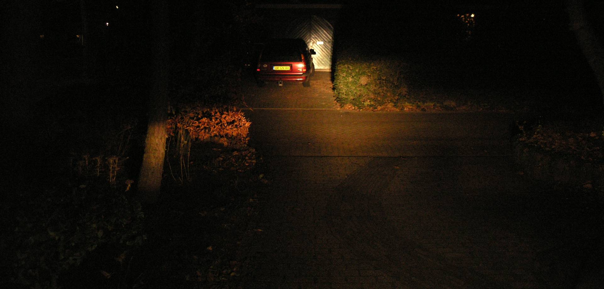

Since Okt 2016 I have the Cyclops H7 LED Headlight bulb kit for the Yamaha Super Tenere, for my XT1200ZE from 2014, see photographs
